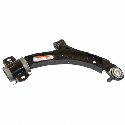

I have an 06 GT Stage 2 I bought used from a friend of a friend.
I replaced the LCA ball joints since they were making all sorts of noise.
Well, the new Moog ones I pressed in seem to be slipping out, and one the boot is completely torn in half. First pic is passenger side, second is driver side.
I'm looking at just replacing the LCA entirely, since I don't really know how old they are. I'm fairly confident they were replaced at some point in the car's life, but I don't know for sure.
I'm aware of the BMR LCAs, but I'd rather not drop the $600 for a street daily.
Moog, TRQ, FRPP, all seem fairly comparable. Since it's a stage 2, I'm pretty sure they came with the upgraded GT500 LCA, but I'm not 100% certain. My main concern is FRPP having zero warranty on parts.
Any ideas or suggestions?

Ford GT500 LCAs and don't look back. Get them from Blue oval industries.
If you check out this thread there are some pics of the stock GT arms and the GT500 arms side by side. Easy to tell them apart even on the car.

That's weird that they would slip like that. Moog are supposed to be lifetime so you could press them out; get new ones and have them pressed back in to save a few hundred if you wanted provided the cups are still good. Or, go with the GT-500 arms. More expensive but stouter in just about every way especially in that area (solid piece of metal).
Buyer beware. If you do get the GT-500 arms be sure to get the Motorcraft/FRPP arms. There are some cheaper knockoffs out there that look the same but can't vouch for their construction.

I am willing to bet that those ball joints were previously replaced at one time by banging them out and in without the proper tool. As such, the hole in the arm has been elongated and the ball joint will not seat properly and move around.
I agree Moog are excellent replacements and usually come with greasable zerk fittings, so you might have the wrong part number?
New factory or preferred GT500 arms will resolve the issue. Just my .02 cents.

@Miker , do you happen have the part number for the GT500 arms? Yours look different from the ones I'm finding available.

This is where I got them but they do not look like the ones I got. Don't know what's up.
Miker
Sep 6, 2022
227
100
96002
Also I save all my receipts and when I look up the parts by webpage from my invoice at blueovalindustries.com it says page no longer exists. I would call them or email and see what's up. The arms they have listed look like regular GT arms in the picture.
Miker
Sep 6, 2022
227
100
96002
OK I contacted them and they for some reason had the wrong photo up. They do have them and they just got 10 sets in yesterday. Also when I got mine there was no shipping or sales tax. Not sure if that's still applicable. Good luck!

Two things...one, the GT500 came out after 06. Two, I'm not sure when the arms were first installed on a GT500, but I recall they were referred to as the Boss 302 arm with a regular, non-Boss ball joint. I think the Boss was 19mm and the regular was 18mm.
Either way, a much more substantial control arm, by several pounds. I've had them in for 5 or 6 years, no problems.
Did a little more fact finding...as I understand it:
05-10 lower control arms (smaller ball joint)
07-10 GT500 arm (same arm as regular 05-10 with (improved?) balljoint and bushing)
10-14 control arm (beefier arm with larger balljoint)
05-10 upgraded control arm (same arm as 10-14, but smaller balljoint so it fits the 05-10)
Note: I think this is due to the change in the balljoint:
05-10 (produced before 8-03-09)
10-14 (8-03-09 and later production)

The metal on the 07 to 09 gt500 arm is much stouter than the 05 to 09 gt arms. The arm to the front bushing is welded on not part of the same stamp. The durometer of the bushings is stiffer. The ones listed also have the provision to swap the heat shields from the stock arm. And the ball joints are heavier duty.
Strange, the part numbers are the same, but LMR and AM pictures don't have that reinforcement.

From what I gathered Ford supplies the photos and the last updated photos were incorrect. It would follow that all vendors of the frpp parts would get the same photos
Blue Oval Industries actually thanked me for brining it to their attention and then why I was chatting updated it to the correct picture.
