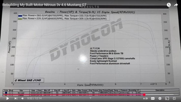

@Midlife Crises, I don't think 7k rpm is all that crazy for a 3v in my opinion. I've heard from many people that they rev theirs to 6800-7200 on stock top ends. Now I think running up to 7k rpm on stock topend isn't sustainable. I'm pretty sure the OEM springs are rated for up to 6800rpm, so I think with some better springs, 7k is not a lot to ask for as long as I'm not holding it at 7k for long periods of time. Four Eyes has all OEM timing components and revs his to 7500 and 7800 bursts when shifting. I'm not saying the 4.6 3v can handle it as well as a coyote or a 4v, but I think it's doable with supporting mods. @Midlife Crises, I have the 2.97 first gear ratio. I don't plan on making huge power like 700-800 plus. I did put in Boss 302 rods when I rebuilt the engine, but I think the most I'll probably want to go with the 3v is around 550 wheel. I appreciate the feedback and concerns.

@StockishS197 If you look at Christian Reyes build, I don't think his bottom end is as doggy as you make it out to be, and he revs his to 7400 rpm on the dyno graph. I would want my dyno graph to look similar to his. It starts to fall off around 7k-7200rpm, which is a good point to shift since you're back at a good spot in the power band after shifting into the next gear. If a SPR cam isn't what I need to get that, then I won't do a SPR, but since I have to upgrade the valve springs to get to that rpm, what's the harm in maybe squeezing out a little more power top-end? On a dyno graph, I'm sure that a SPR cam would probably make a little less power under 5k to 5500rpm, but I think if the increase in power is the majority of the rpm band when racing or doing pulls, that's worth it to me. The car only has a CAI right now, and I highly doubt that with all those mods, I'll be making less power bottom-end than what I make right now. I'm fine with how the bottom feels right now, so I don't really care if most of my gains are top-end which is what I care about.

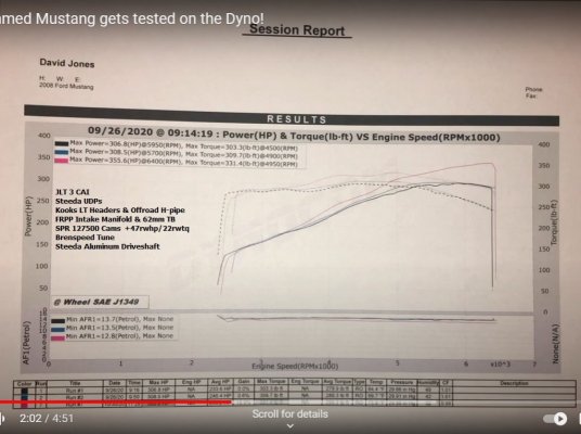

There isn't a single aftermarket cam that'll outperform the stock cam from idle to 4400rpm, and all will sacrifice torque below that rpm to some degree. If you also add an aftermarket intake manifold, the combination of cams/manifold essentially takes a hit to the torque curve below 5000rpm and adds torque above that. This is Four Eyes before and after adding Detroit Rocker cams and the Ford Performance IM.
The stock powdered metal rods are light and strong enough for 7000rpm in a N/A 4.6 but for insurance and peace of mind, I'd prefer the Gen 2/3 Coyote (same as Boss 302) rods if anything nearer 7500rpm is the goal. You'd also need to consider a higher capacity oil pan and HV pump with billet gears for 7500rpm. Sustained engine speeds of 6500rpm & above will require locked out phasers to prevent their failure.
If you're looking for ~360rwhp your peak HP is going to be at or near 6500rpm with peak torque of ~330rwtq arriving at or near 5000rpm. The dyno graphs I posted tell the story. Therefore you'll want to rev the engine up to 7000 if you're going to exploit the extra top end performance. If you want a strong 2500-4500rpm midrange for street use, stick with the stock cams & IM with delete plates and settle for a ~6500rpm limit.

At the end of the day the 3V is a very good engine but it can never match the performance of a Coyote across a wider 1500-7500rpm range even when built as an 10.2:1 compression 301ci stroker (Four Eyes again :D) simply because it's constrained by a single exhaust valve per cylinder, a single camshaft on each bank and, consequently, the inability to vary the lobe separation angle as well as the intake/exhaust centerline angles in order to widen the power band. Once you lock the cam phasers, the power band becomes even narrower.
