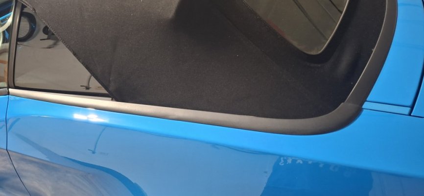

Want to remove these pieces for clean-up and refinishing. Has anyone removed these successfully? I have read the one on the rear is on with adhesive. Mainly the side ones are the priority, but the entire set is the goal. All guidance20260116_083615.jpg20260116_083625.jpg20260116_083633.jpg is gladly accepted. 2013 car.

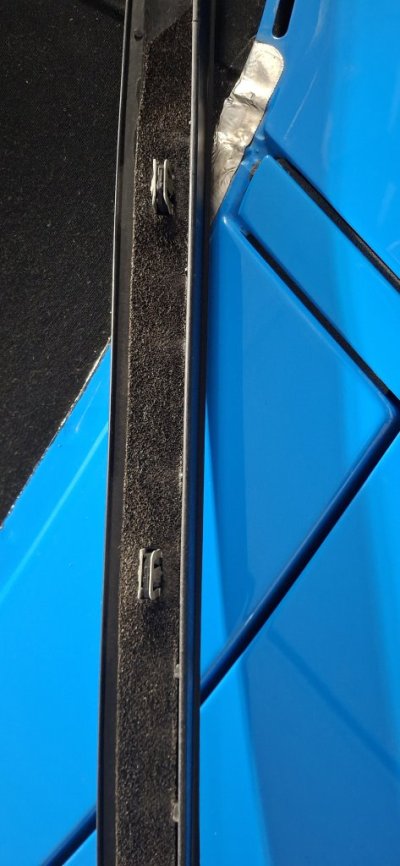

Learned a ton, First off the side trims come off by squeezing the clips together from below. Lower the top a tad, there are five clips that get squeezed together to release shown here

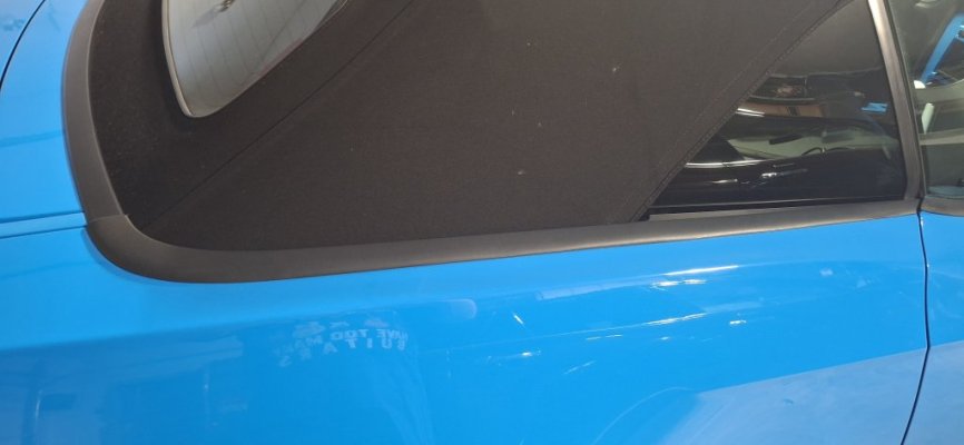

then the part by the rear side windows have three clips, pry trim straight up starting in the front, wiggle and pry. these three are a spring type clip. see below
Same on both sides of the car. rear piece is easy peasy just slide it forward after side trims are removed.
