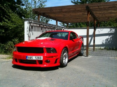

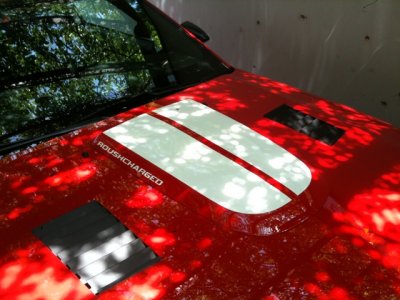

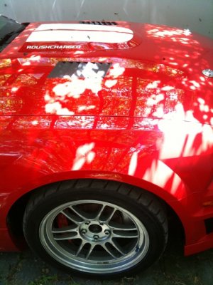

Ok, I have been tracking my car since purchase in 2008. I started having issues with heat under the hood when smaller pulley for roushcharger has been installed. Another issue was lack of venting for correct airflow outta engine bay during high speed driving.
This is what I did:
Mezziere water pumps
Steeda heat exchanger
Fluidine radiator
Roush high flow grill
Supersnake vents and functional roush scoop.
Now I am a happy camper and can literally abuse the car for an hour without any issues.
hope that helps,
Jan

Can you please provide some details on the Supersnake hood vents?
Philostang
Chrome Hater
Dec 19, 2009
429
Chicago
I thought I had seen these for less, but you can pick up "replacement" Super Snake hood vents at different vendors, such as this guy.
