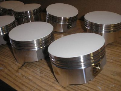

anyway the chambers were coated with the same material but i used a heat gun to cure it since my heads were already assembled with valve seals and i didn't want to chance messing them up in the oven.
it isn't thick enough to make any change in compression it just keeps the heat in the cmbustion area instead of soaking into the piston. it's an old trick people did back in the 80's-early 90's when there was no HPC or Swain coatings. Hot Rod magazine did a dyno test way back and got 40hp on a high compression SBC motor just by coating the pistons.
If the pistons are new and clean what the heck all you need is some VHT white header paint # SP118 and an oven. there's a tech artical on VHT's website i think for the steps involved. ...found it here ya go.
Paint must be completely dry before curing
Heat to 250°F (121°C) for 30 minutes
Cool for 30 minutes
Heat to 400°F (204°C) for 30 minutes
Cool for 30 minutes
Heat to 650°F (343°C ) for 30 minutes

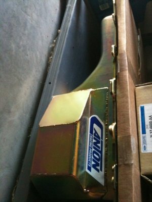

I've got that Canton 7qt pan in my car and it's a nice piece. The only thing that sucks is that the kicked out sides make it much harder to reach up from the bottom to get access to the header bolts.
My car takes something like 8qts of oil now with that pan.

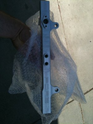

As for that hardware, it's most definitely not ARP stuff. The longest ones are stock main bolts, which you definitely do not want to re-use. The short stubby ones are the stock main sidebolts which are fine to reuse and for which an aftermarket replacement doesn't exist.

Well after much deliberation I have decided to send my rotating assembly to livernois and have them make me some custom pistions.. 11:1 compression. Balance it again, and build me a short block. As soon as I can afford it. Now just to convince them to ceramic coat the pistions before they install them.. Lol
They don't have to "make" anything. Manley makes a flat top piston for that combination that will yield 11:1 compression. It will have to be rebalanced though.
