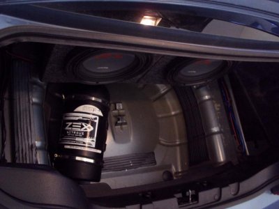

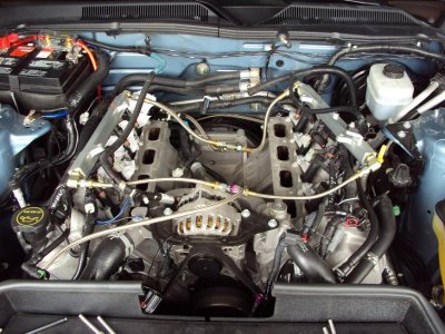

ok, time for a update. so my plan now is to go with a built shortblock at some point. but i have all this shit in my garage i may as well use until then. as you can see i have done some work. installed nitrous. controlled by a coolingmist smart controller. it is awesomeness, its a traction control window failsafe nitrous controler, monitors my wideband, fuel pressure, nitrous pressure, TPS, RPM, speed, and factors it all in. also it controls my bottle heater based off bottle pressure. and my BAP based off WOT and fuel pressure. thats just how i programmed it. sure the BAP is not really needed, but i got it cheap so whatever.

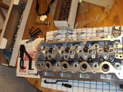

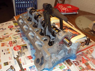

right now, like right right now. i'm installing my cams and doing a spring job on my new heads. i came up with one question. do i need to put lube on the camshaft bearing cap bolts? or any sort of thread lock? all the instruction i have read dont mention it, but i should ask to be sure.

Don't need lube on the cam bearing bolts. Just lube up the bearings before installtion with fresh oil

oh and to update about my car, I started doing the spring job but found my spring tool to be faulty, so that is on hold until I get home. All I got done was torquing the cams down, lol. Did manage to shoot a spring across the room :( but freedomracingtools messaged me back with in 10 minutes of my message to them and has a replacement on the way. So far customer service is superb. I understand that in the manufactuing process faulty things get out once in a while.

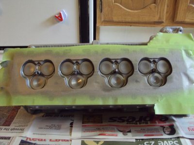

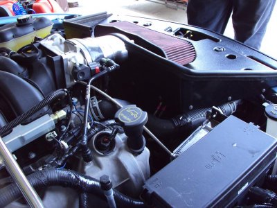

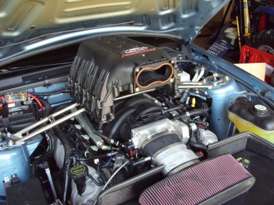

small update

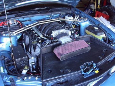

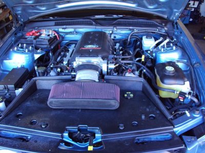

Intake manifold installed with a shiney new DIY oil catch can.
Springs changed to higher lift capible springs, head combustion chambers painted with VHT header paint, not cured yet.

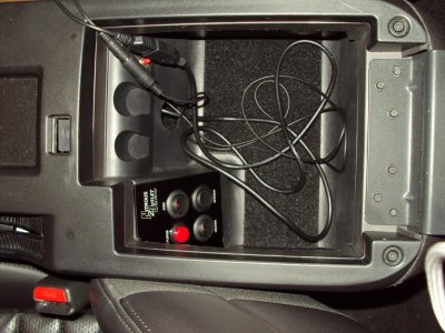

Nitrous switch panel, nice and hidden, bottle can be covered with the carpet.
