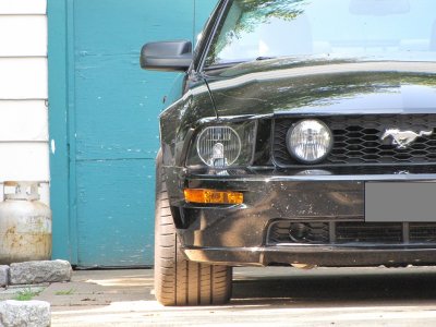

Without knowing what "doesn't cost a ton" means to you, I'd go straight to 11" wide wheels, most likely Apex or Forgestar. That'll let you get more out of 305/xx when you feel you're ready for that much tire (including financially) but will still let you run 285/xx in the meantime.
FWIW, anything over 10" wide really needs to either have slightly different offsets (front vs rear) or spacers and ARP studs for the front.
My own "track day" set - I do run a separate street set except when I get lazy about swapping the track set out - is 285/35-18 on 18x11. 19's wouldn't be any different, except that you might think about running 5 profile points lower with 19's. Please excuse the 100+ mph bug suicides, picked up at NJMP.

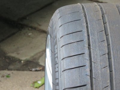

Yes, 285's on 11's is a mild stretch (it's a max-recommended fitment). But it's great for turn-in response and steering precision.

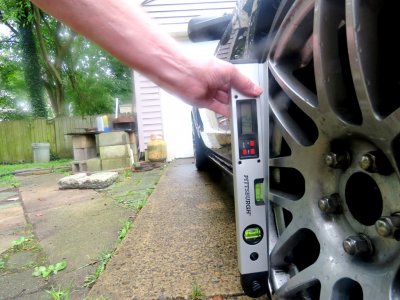

Norm, kinda tough to tell from the pix, but at 1st glance, it doesn't appear that you have a lot of camber dialed in? How far inboard do you have your steeda Strut mounts adjusted ? Can you share a pix. You can only put so much neg camber on the steeda hd strut mounts, but I'm sure it's slightly more than what ur pix depicts. As far as strut to tire clearance, a slightly thicker spacer would solve that issue, like perhaps another 1-2 mm thicker...provided of course that the studs are long enough.

At right around -2° it's right in the middle between a more typical performance DD setting (in the low 1.x range) and a dedicated track setup in the high 2.x's. I've been through the camber-swap-for-autocross deal before (different car), and don't care to get involved in that any more. Aim Solo datalogs are a good bit past 1.1g (I've seen 1.3x peaks, which may or may not be all that meaningful), so I'm happy enough at least for now.
The strut mounts were pushed as far negative as they would go, offhand I'm not sure why they wouldn't go any further or what was stopping them. My driveway is flat (side to side direction) to less than 0.1°, and this picture was taken on the "low" side.
