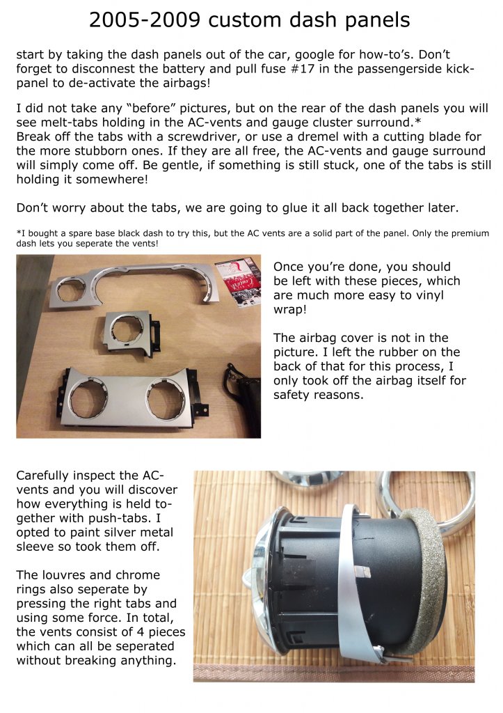

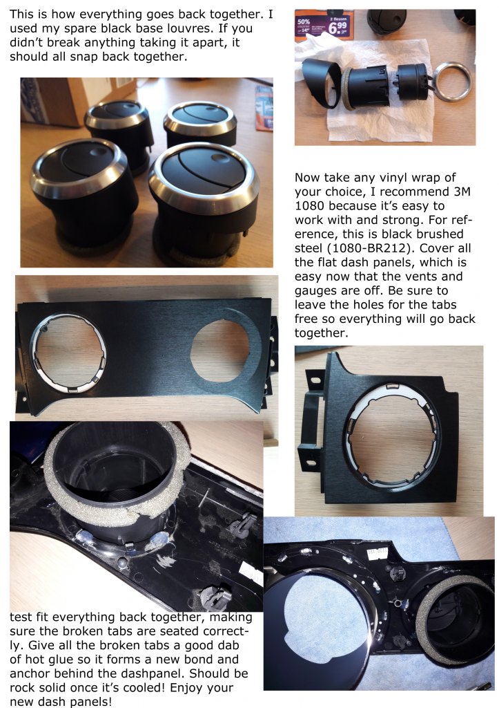

I added a GT500 wheel and wanted to match the brushed metal look in my dash panels. So I took apart my premium panels and turned them in to this!
The pictures were very popular on facebook, so I decided to make a little how-to with the pictures I had. So if anyone is interested you can follow the steps and get creative with paint and vinyl wrap, etc. Many options and combinations are now at your disposal!
Have fun this winter!
