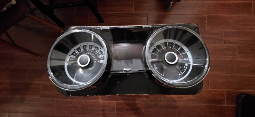

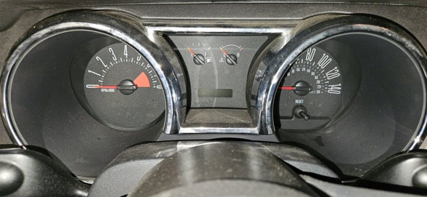

@Scott88 What did the final product look like? I have the cluster from the 2013 Mustang GT donor car along with the engine and trans. I want to install the 13 cluster into the 07 Mustang GT/CS. I have attempted and found that the plug in the back is different to start with, how is that handled? I have included photos of the cluster I want to put in, and what is currently in the 07. Is this a possibility, as I want the mileage to match, the engine/trans only had 36K on them so that would be nice to have them match. Thanks.
