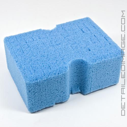

I actually use the same blue fiber sponge from Walmart you mention in your OP. My buddy had advised me to toss it with extreme prejudice. Haha.
So. Am I setting myself up for swirls using this sponge? I would think the main issue with using a brush is getting enough suds to the car and keeping them there.
Thanks!
I don't like brushes for washing cars.
I don't see a lot of other detailers using brushes.
I don't see a lot of professional detailing shops selling brushes, either.
IMO, I'd rather use a MF spong or a sheepskin mitt. With either of these you need to use as little pressure as possible to avoid scratching.
If you're washing in a straight line like you should, you don't have to worry about "swirling" anyway, though.
If you're using a grit guard and proper technique you should have nothing to worry about.
Most brushes will scratch the car themselves, anyway. I know which ones he's talking about, but they are like $100 and I can't see them being much, if any, better than using a MF sponge or Sheepskin mitt.
That being said. I'd never use just a normal sponge on a car that doesn't have the MF strings on it. Even though some detailers use what's called a "grout sponge" with good results.
Blue-Grout-Sponge-P293
And as far as you setting yourself up for problems. . . I use the same thing as you and if I don't get lazy and quick detail the car I can go a LONG time before I get any microscratching showing up.
