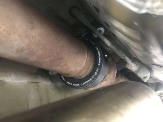

Ok, the verdict is..........fact check-TRUE!
This S197 center carrier bearing assembly setup does exactly everything the folks at JXBPerformance said it would do to the letter........
The Track version durometer bushings are very stout when fully compressed into assembly........I could only move the center bearing 1\8" of movement.......most of this movement was found at the 2 mounts to unibody......not in the center bearing sandwich bushings inside the JXBPerformance carrier assembly. So, when JXBPerformance said this setup removes the driveshaft slop in the center carrier area of the OEM Ford 2-piece DS.......they ain't lying.
Driveshaft is quiet as a church mouse during rotation (tested up to 70 MPH to date.......so far, so good) w\o any harsh NVH anywhere........but since I have a fully trans mounted MGW shifter (installed on a Blowfish Racing Remote Shifter Mount bracket.......the V2 version.....is now discontinued) I can feel the extra NVH from this firmer mounting thru the shifter handle (mostly thru the front U-joint at the trans flange) but the connectivity improvement thru to the rear axle is very noticeable thru my Eaton Detroit Tru-Trac diff when the clutch is engaging\disengaging........in a lot of ways it seems to have the connectiveness feel of a 1-piece driveshaft (I also own a Ford Performance 1-piece DS w\ the 2 Spicer 1350 U-joints & ran it in this car from 2018 thru 2022 on a full BMR 05-09 S197 rear suspension setup before I put my OEM Ford 2-piece DS back in so I know of what I'm talking about) but is much smoother due to the 2 CV joints in the rear 2-piece DS half shaft section along w\ the Roush 3rd Link UCA assembly (a Roush-modified OEM Ford 07-09 GT\GT500 UCA assembly.......is now discontinued) & OEM Ford 07-14 GT500 rear LCA's I have installed replacing all the BMR suspension parts as well but retaining all the full rear axle control under full WOT launches........at the OEM Ford 08-09 Bullitt ride height (have a full set of OEM 08-09 Ford Bullitt take-off springs installed).
IMHO, I give this JXBPerformance S197 DS Center Carrier Assembly a thumbs up as I find all the descriptions given by JXBPerformance are indeed true as I also felt\observed as well.
I believe y'all will like the Street durometer version bushings just as well.......they're just a bit softer than the Track version but not by a lot......FYI.
As usual, YMMV............
The install was pretty straight forward..........I did the install w\ my Kooks mid pipe still mounted (detached the exhaust pipes from the mid pipe & bungiee'd the pipes out of the way......video showed to remove the mid pipe section) & the DS still mounted in the car on jackstands..........but if you have a set of the HF Daytona 6-Ton jackstands w\ a 20" stand height set under a pair of Steeda Jacking Rails it ain't half bad........but a lift is THE way to go if you have access to 1. I found that if you have a 4" hand held grinder using either a 4" grinding wheel or cutoff wheel, I could access the top area section just behind the old carrier mounting flanges thru the area between the mid pipe ends & cut the upper flange section out to remove the metal housing part then a good & sharp 2" pocket knife made short work of the rubber section right down to the part of the rubber that will be reused (found 4 sections already had cracked & separated). The rest is as shown in the install video. I used some blue Loctite on all the bolts for insurance. Install w\ the lettering facing towards the front of car (or towards the transmission) so all properly centers up inside the carrier assembly when mounted.........as instructed in the video.
Good luck!
PS edit--install video won't run here so go on JXBPerformance web site & run it.

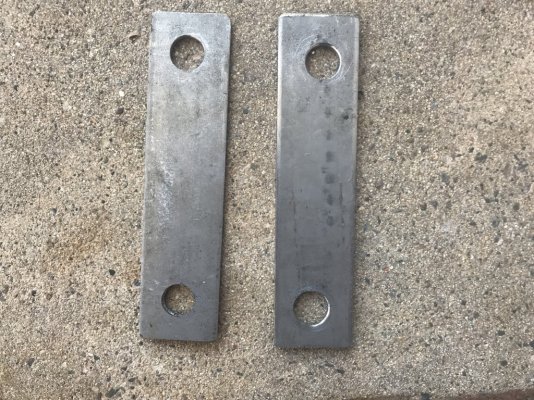

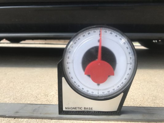

After running this setup for a while, it came to mind to whip out my angle finder & physically check the actual operating angle of the front U-joint DS section since installation of this JXBPerformance S197 Center Carrier Assembly using their Track version rubber inserts (stiffest durometer) as I surmised that by stiffening this carrier up this has to have an effect on this..........also remembering that I also had this Blowfish Racing Remote Shifter bracket installed (V2 version which installs between the trans & trans isolator mount thus will raise the trans up by the thickness of the V2 bracket "square slot".......) thus the engine\trans flange angle wouldn't be at std OEM design front DS operating angle........which may be what I was detecting thru my shifter handle.
Been had this Blowfish Racing bracket installed since early 2018 & never crossed my mind to check this out...............
So, I got her in the air & checked this............found it to be out of alignment by a fair amount (according to Ford design for a typical 2-piece DS layout, the front U-joint in DS section between the trans flange & center carrier\U-joint or CV joint should be operating between .5*-1.5*......just enough deflection to facilitate adequate grease distribution thruout the U-joint needle bearing caps).......found trans flange to be at 2* down w\ front shaft & rear shaft sections at 6* down which put the front CV joint at 0* operating angle thus the 2-piece DS was indeed mimicking a 1-piece DS alignment for a front U-joint operating angle of 4*.......which is outside of the max recommended operating deflection angle of 3* for a typical single U-joint.........thus explains why the low RPM flutter I was feeling\experiencing. Since the rear shaft pinion flange has a CV joint mounted to it, this made up for any vibration issue coming from the pinion flange, so all is coming from the U-joint off the trans flange.
So, to fix this I needed to lower the trans flange to reduce the U-joint operating angle & I wasn't gonna remove my Blowfish bracket, so I made some trans crossmember shims out of 1-1/2" W flat steel plate I picked up at Home Depot (1/8" & 3/16" thickness to try to counter the Blowfish V2 bracket slot thickness.......guessing between 3/16" to 5/16"........have slept a few days since installing this part) to bring the front U-joint DS section operating angle back to specs.
Found that the OEM Ford M12 x 1.75 x 50mm (actual 38mm of thread) trans crossmember bolts would only accommodate the 3/16" shims & get a full thread thru the nut insert in unibody so I didn't install the 1/8" shims yet (but I did have to buy 2 M12 x 1.75 x 50mm Grade 10.9 bolts.....longest O'Reilly's had in stock.....to facilitate my 2 mid pipe exhaust hangers & maintain full thread to safely\securely achieve the 46 ft-lbs TQ spec) then rechecked alignment afterwards & found I got pretty close.......trans flange now reads 3* down, front DS section reads 5* down (which sets front U-joint at 2* operating angle now instead of 4*) & rear DS section at 8* down & rear axle pinion flange at 5* down (which sets the front CV joint in rear DS section at 3* operating angle & pinion CV joint at 3* operating angle.......so meaningless for CV joints & is why Ford used these in this manner in the rear DS section along w\ solid non-adjustable UCA & LCA's thus a fixed rear suspension geometry in the 3-link rear suspension).
Test drive after work was finished showed that the low RPM DS flutter once felt was now practically gone so is now verified that this was being caused by the front U-joint being operated outside of its max deflection range of 3* while running the JXBPerformance S197 Center Carrier using the Track version rubber inserts. Another item observed is that this DS realignment affirmatively improved the DS rolling moment even further.........as it should be due to the front U-joint binding being reduced (car will now start rolling down my driveway on its own upon clutch disengagement w\o brakes applied as seen in pictures provided below...........this driveway section is on a 2* incline slope.......just enough to ensure water runoff). Rotational smoothness also improved as well as the connectiveness feeling that the Track version rubber inserts in the JXBPerformance S197 carrier assembly already gave.
I've got some uxcell M12 x 1.75 x 60mm grade 10.9 flanged head full thread bolts coming along w\ some M12 x 37.7mm OD x 3 mm thick flat washers coming off Amazon to finish this out so that I can get my 1/8" shims installed as well.........hoping this will get me to\within the 1.5* operating angle spec of a front U-joint DS section in a 2-piece Ford DS design parameter.
Just putting all this here for anyone considering installing 1 of these setups.......especially if using the Track version rubber inserts........to also consider checking the front DS section U-joint alignment angles afterward to ensure that the front U-joint operating angles are at least within 3* but optimally within 1.5* while you're under there.
The shim measurements are 6 1\4" L x 1 1/2" W w\ hole centers @ 4 9\16"........I opened the holes up to 9\16" ID instead of 1\2" ID to allow some wiggle room just in case 1 of the holes got a little off during drilling.
You'll have to make these yourself as I've yet to find anyone making them commercially.........
Realistically, you could use steel body shims for 1\2" bolt shanks slid in at each end of crossmember holes parallel to unibody section since the crossmember only clamps to unibody around each bolt hole, but I like this 1-piece design better from a looks perspective.
As usual, YMMV.
