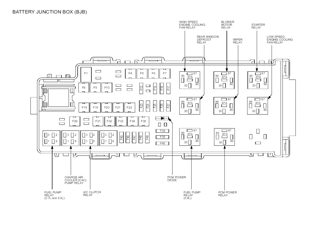

Car is a 2011. Was idling and driving for a bit. Out of nowhwre it srarts running rough then clears up. Rough running like fuel starvatio (from what i remember with my fox bodies).
Turn car off and it wont fire. Let it sit it fires, runs rough then clears up. I get home and fire up my procal to read the code and i get this:
P0627. Fuel pump (A) control circuit/open.
I do more research and there is a TSB. I check it (chafing of fuel pump relay wires and blown fuse) and it is fine.
So since it is intermittent i assume it isnt a relay. Does that seem to indicate fuel pump issue?

Thanks but i digured that. Wondering if it means it is a pump. Or will a relay intermittently stick
