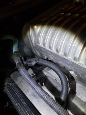

I think I found the issue. I did the induction smoke test and found a threaded hole in the SC manifold on the passenger side. I attached the pic. Based on what pictures i see in the internet, it looks like a threaded plug belongs there. I guess is must have broken loose and vibrated out. So now I'll be trying to figure out the thread size and get a plug for it.
I'm thinking i can start the car and plug the hole with my finger and see if it starts running better. i just need to wait since it's so freaking loud.
Mar 7, 2009
89
10
Barrington, IL
Confirmed... plugged the hole with my finger and it starts running back to normal. Thank you guys for the help. It really was a learning experience sharing your knowledge.
