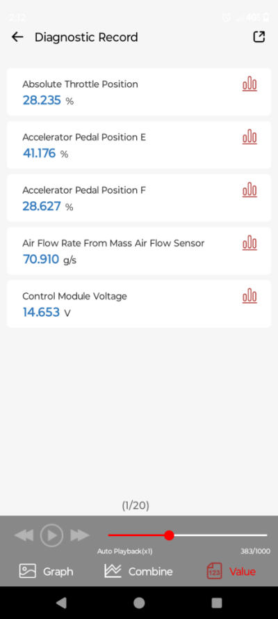

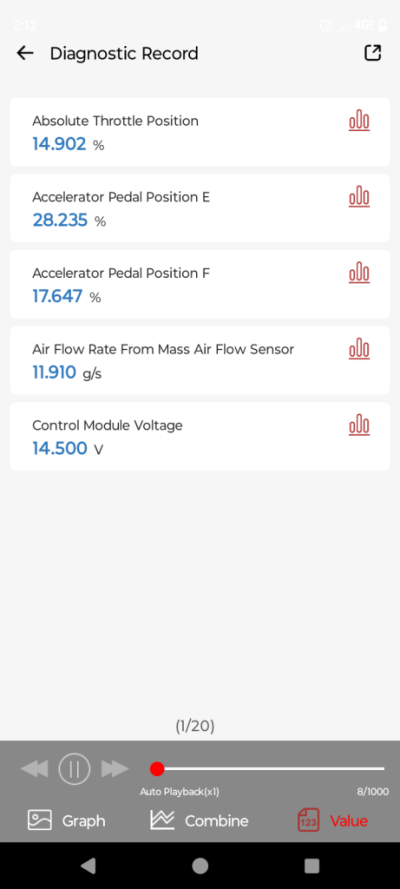

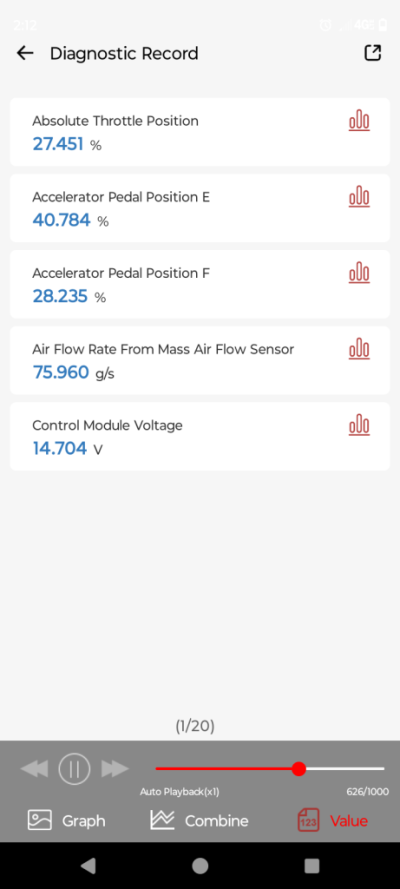

On another note... Yesterday when I was hooking up the laptop to the sct in my car.. I noticed that my interior lights would flicker every now and again.....
whitmanink
Dec 28, 2020
592
258
denver pa
I got another compression tester and the 12mm won't thread in , so I'm confused on that one ...
But none the less.
I took my car out and wanted to try to throw a code so I drove it for about 3 miles .
It idles fine but after about %27 throttle it backfires and misfires ..
The thinkdag said no knock detected on any cylinder so idk .
I drove around and logged these inputs ..
For those advanced guys ,
Is it normal for the throttle position to be at %14 when my foot is off the pedal? .
I don't know maf readings but I had that up as well .. anyone who might be able to decipher this ,id greatly appreciate it

cavero
Jun 30, 2012
896
270
NoVA
Regarding the 14% at idle, the throttle has to be open even a little bit at idle. I haven't had my car for the last month so can't go out and check, but pulling up a data log I did back in April, my throttle pos readings were roughly 12% at idle after the car was fully warmed up. I have the GT500 TB and a centri blower, so the 12% I was seeing vs 14% you have, probably not something to worry about.

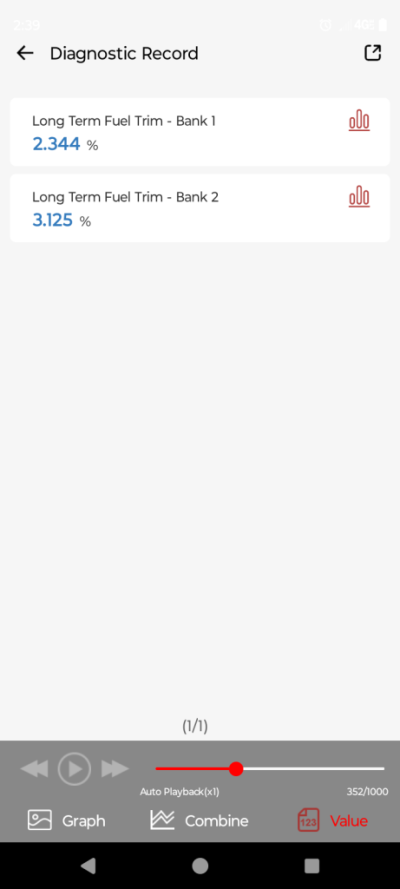

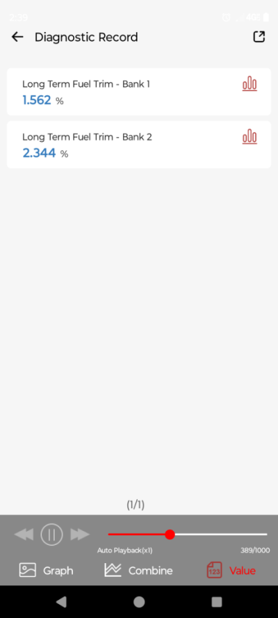

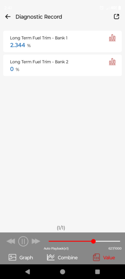

whitmanink
Dec 28, 2020
592
258
denver pa
Ok also looking at fuel trim 1 and 2 .. it's getting. Different numbers sometimes .. others they are the same?
Not sure if that's saying anything or normal?
StockishS197
Dec 24, 2024
434
377
Houston
STFTs/LTFTs changing is normal and expected. If your trims are +/- 5% bank to bank, that’s not the issue.
whitmanink
Dec 28, 2020
592
258
denver pa
