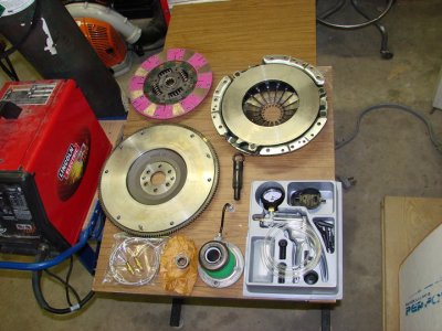

Here is the Correct Picture of the Clutch Disc.
Here is a Picture of the Spec 2+ Clutch and the Exedy Clutch.
Look at the difference in the Springs.

That's weird. The part number on mine is EXE-07952CSC (the same as yours) and it is a disk instead of a puck.
