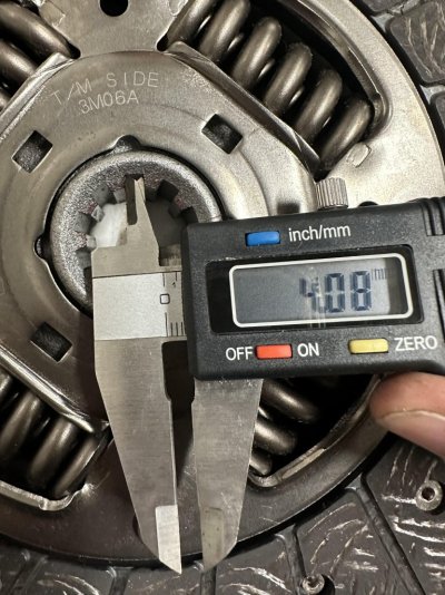

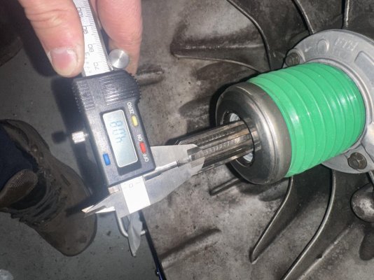

The pictures are: How far I can get new clutch on, measurements of new clutch, measurements of input shaft, proof old clutch at least fits on input shaft.
Is it just Exedy quality control or is my input shaft messed up? I took some measurements with some cheap calipers and there is almost no room for play at all. My old clutch is at least .01" bigger on some of the teeth. Has anyone else had this issue or this there anything I could try? Any advice is appreciated!

Sounds like the input shaft might be slightly twisted. Common issue.

if the shaft was twisted, wouldnt you be able to see that?
and if its twisted an .0004 , you should still be able to clock the clutch onto the shaft by letting it follow the "twist"? unless he has a +550 hp car, with a stage 5 clutch ,, i dont see a twisted shaft

Take the clutch alignment tool and fully insert it in all the clutch disc (old, new, etc.). If the tool goes in all the way with no binding then the issue is with the transmission input shaft.

The fact that the old clutch disk only slips on the shaft a certain way tells there is something wrong with the shaft. Like 86GT351 stated, it is not uncommon for the stock input shaft to develop a twist. It does not have to be abrupt. Just a few thousandths over the length of the splines and the disk will bind on the shaft.
