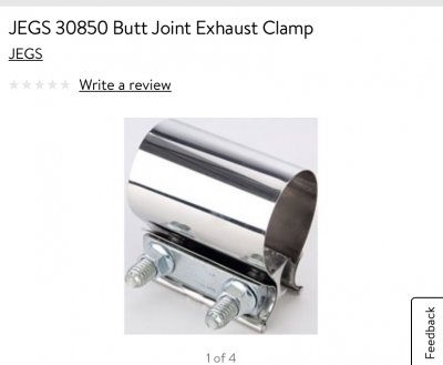

Laga
Aug 10, 2019
1,133
656
Chicago
E544F849-6B2B-462C-A190-4900FC0C138D.jpeg You also use a butt joint clamp. These came stock on my 05 and have worked great. This is an example. Part number is probably wrong.
