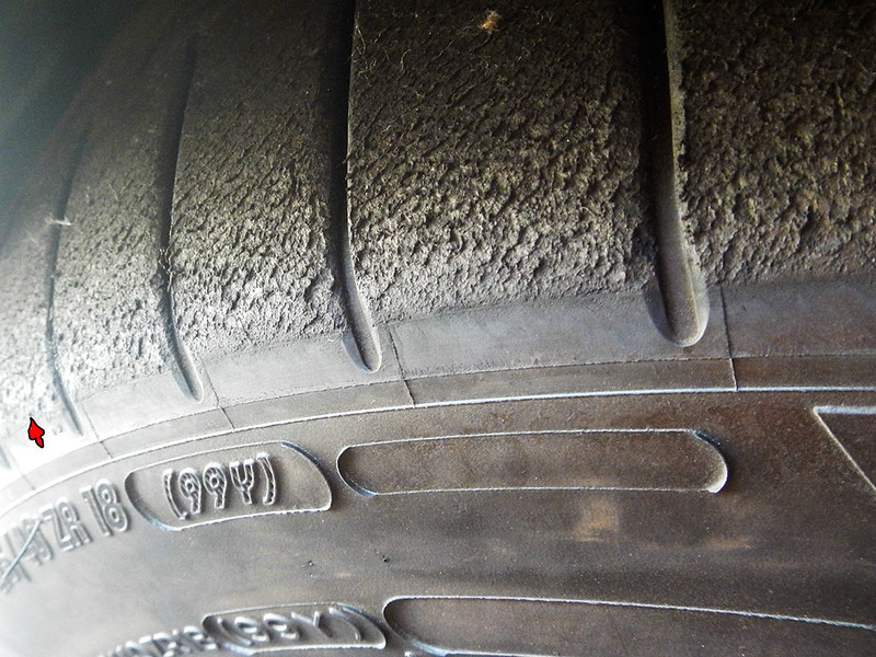

This is the Left Front Pilot Super Sport's response to a bit of understeer on about eight autocross runs on stadium parking-lot asphalt.

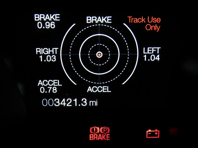

Tires are 275-40x18 on 9.5-inch Shelby CS56 wheels. Car was a near-new 5.0 convertible, all stock except wheels and tires. I have no idea what relationship the "G-meter" readings bear to real-measurements in the real world. (Photo was made several months after the readings were obtained/recorded; red mark is wear-bar locator.)
Edit: For comparison, this is a reading under similar circumstances on a 5.0 coupe. Brembo Pkg, as-delivered Pirellis on Brembo 19x9 wheels. The convertible accel numbers are from a well-prepared drag strip at Barona; coupe accel were from a notoriously under-prepared strip at Qualcomm Stadium.
If you are tearing up your tread like that you may want to put some street miles on your tires.
No kidding.
by putting some easy street miles on you smooth the tread back down. Once a treat starts to get chewed up pushing on it more and more will just cause larger chunks to break off. By smoothing them out at the end of the day you break the cycle of bigger and bigger chunks coming out.

The PSS tire is one of the most sensitive to alignment and overdriving I've seen. To get it to wear "right" it really needs a dead-nuts alignment that unfortunately requires you to run it, read it and then make adjustments to the alignment. That's what we do for ALL our competition cars, but neglecting it with the PSS can end up with a chewed up tire or two.
And it's sensitive to overdriving. Figure out the alignment it likes and drive it, but don't slide it. If you've got the car unbalanced (one end has a high slip angle relative to the other) then you are most likely overdriving one end of the car.
