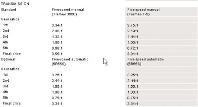

Is there a calc for us Auto guys?
You can do it by hand knowing the transmission gear ratios
See attached photo showing comparison of manual transmissions to automatic transmission.
Mike

Why would it be any different for an auto? You still have tires, you still have a differential with gears in it...it's gonna be the same.

Thanks Mike. Maybe my internet searching sucks, I wasnt able to find anything like that.
Math..that I can do. thanks again.
Mike
I was wanting it for general info Hawg. Not just to know final gear ratio. :thumb:
