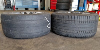

Well, one thing to remember is that every tire model is different.
The Goodyear Eagle F1 runs wide, Nitto 555R runs narrow.

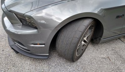

The picture below is a Nitto 555R 305/40/18 tire on the left and a Goodyear Eagle F1 285/40/18 tire on the right. Both are mounted on the same 18x10 wheel.
There's almost no difference in width. Which probably is the main reason that I was able to run the Nitto 555R in that same 305/40/18 size on the FRONT of my '13 GT, and even autocrossed with them on, with no rubbing (second picture below).

Great Video to watch, Plus I can't believe those two tires are so close in actual size with the specs they have I can see where the 285 will work upfront with Nittos being that much more narrow. After looking at those pics, may change to a square 285/19 set up.
Very awesome find on the video and very informative Gabe. Anyhow what I meant to say was when turning the wheel full lock, part of the tire would make contact with the inner wheel well next to the strut tower. Therefore my mistake for not clarifying accurately lol. Also the clearance issue was with the stock Goodyear Eagle F1 for which you did confirm runs a bit wider, so perhaps that was also a contributing factor behind the clearance issue? At any rate, It appears the Continental Extreme Contact Sports are the only tires I'd be interested in that are available in 285/40/18" sizes. Otherwise, I may end up considering Firestone Firehawk Indy 500's in 275/40/18 instead :shrug:
