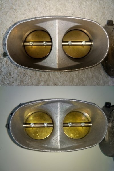

A 62mm TB may yield a 4hp gain at best so you decide if it's worth the cost. I'd only suggest getting one if the engine's NA but with ported heads, performance cams, upgraded valve springs, performance intake manifold, and a 7000+rpm capability. Otherwise just port your stock throttle body like I did mine (see image below).
Dino - What did you do? It looks a little like you polished it with a dremel with a wire brush. Maybe a sandpaper roll? Did you polish only the atmosphere side or the motor side too?

I did the main grinding on the inlet side using a Dremel with a carbide cutter, and then polished it as much as I could with a sanding roll. I left the bores themselves untouched at 55mm each.
