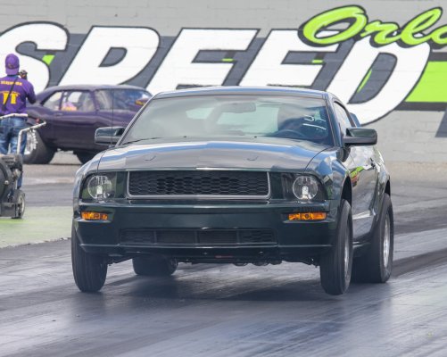

I ran Koni yellow on mine, front and rear. But mostly kept them on the softest setting for street use, which is about the same as the Koni orange (non adjustable). A nice aftermarket option that matches well with the Bullitt spring setup. 51979232-IMG_1783.jpg

I went with the Koni STR-T orange. Also got the GT500 front LCAs, GT500 upper strut mounts, GT500 rear LCAs, FRPP aluminum drive line, and the 2014 GT500 diff cover. SO glad I did all I did when I did. Prices have really gone up...

Is your Bullitt lowered? These look like their matched to the stiffer rates on lowering springs
