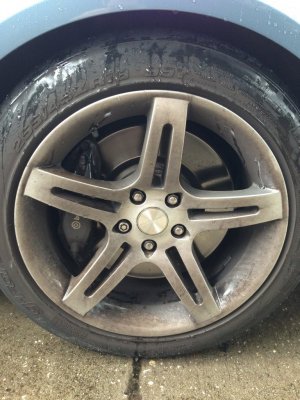

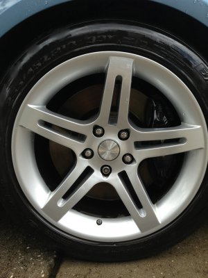

I'm still using OEM brembo pads on mine and it sucks! Here is a before and after.ImageUploadedByTapatalk1373847670.790238.jpgImageUploadedByTapatalk1373847683.023291.jpg
