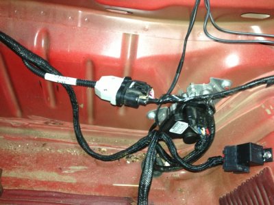

So one more question, what do I do with the 2 wires in my hand? I don't want to make assumptions and cut stuff up. If you have a good write up with pics that could could help me.
Thanks

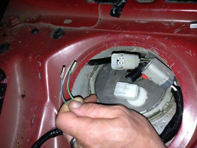

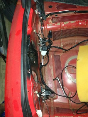

Okay so I don't see why I'm getting so lost in such a simple thing lol.
Okay so I plugged my new harness into my new fuel pump, I am left with old harness and two wires what do I do with that two wires? cut off the old harness and splice them onto the two wires? They don't just slide in to that harness what the hell am I missing?
Now does this look right?
No don't cut off the old harness, fixing to mess up. follow the link that Bruce left you.

My wires do not go into anything.
Do I need to go buy a connector to adapt?

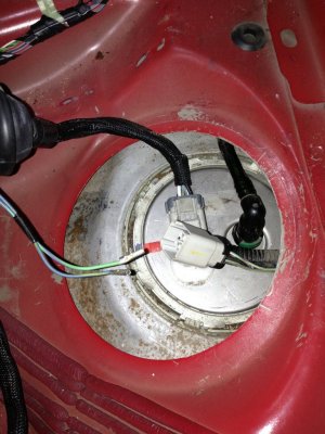

Goody05
Jan 8, 2012
219
Omaha NE
I don't have any connector I am having a hell of a time figuring out what connector I'm supposed to have. It's starting to piss me off because this is the last step in my supercharger install and it's killing me. Lol.

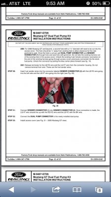

They plug into one of the existing connectors on the new harness. Iirc it has 6 pins.
Edit: I think they do plug into a special plug that comes with the kit. That's why you have splices on it, because the previous owner didn't have the plug either. If I'm thinking right you are going to have to splice into the harness.
I take it you bought this used?
Goody05
Jan 8, 2012
219
Omaha NE
That's the best link yet, thanks. So it still looks like I am miss a clip on my new harness witch Is throwing me off because I need to know if I can splice in the new wires or do I look for a new harness
