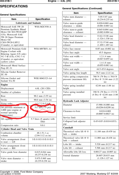

I seriously doubt that a high mileage 4.6 3V will generate anywhere near 100psi oil pressure with a GT500 pump.
Factory spec minimum oil pressure is 10-15psi at hot idle and 30-40psi at 2000rpm (doesn't specify if it's 5W20 or 5W50).
In the real world a healthy 5.0 will be holding around 25-30psi hot idle and 80-90psi above 2000rpm on 5W50. With 5W20 or 5W30, oil pressures will be lower.
