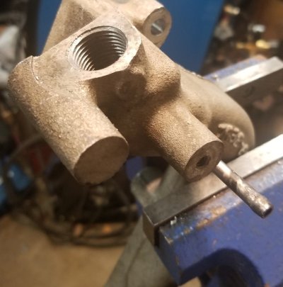

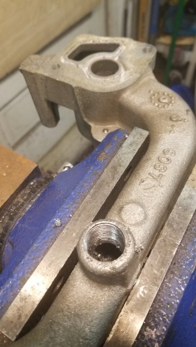

I found an 06-08 Explorer 4.6 3V coolant crossover for sale for cheap (compared to what the Mustang ones go for), have been thinking about this as I'm pretty sure my car still has the original radiator hoses on it and time may come that I have to change them out.
The Explorer one looks almost identical to the 07+ GT crossover, except it doesn't have the nipple on the bottom for the heater hose (but the boss is there-could easily drill and tap and add fittings) and one of the standoffs isn't threaded (again, could drill and tap).
Is it otherwise identical?

Ah I see now the Mustang crossover also doesn't have that nipple on the passenger side...maybe that is just a little too different.

Take the extra nipple out and tap the manifold for a pipe plug. A little extra work, but you save how much?....I know how much those Mustang crossovers go for.....I've sold four of them!

So another question, does anyone know offhand what size the bottom nipple coming out of the crossover is so I can figure out what size I should tap it for?
