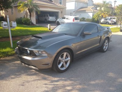

Nice ass Stang bujeezus! Thks for the input! I attached a shot of mine. I definitely need to upgrade to the bigger tires and lower it. I think I'm gonna go with the H&R SS springs although the front could be lowered a little more than an 1". I don't think lowering the rear 1.5" will be enough. I just got a CDC front chin spoiler that I need to put on it. Any other thoughts would be welcome! Thx again!
