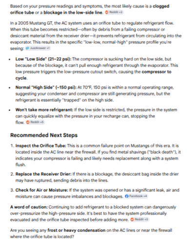

Just for kicks, I asked the same question you did and got this. I had a similar issue years ago on another Ford, and the orifice was clogged, and the A/C shop fixed it. Hope you get the troubleshooting worked out.

Thank you very much, that sounds exactly like what is going on with my 07 and suspected. I noticed today that I can hear a hissing sound from the area where the orifice tube is located while the system is operating. I'm guessing it's restricted although it's still working now it won't be long again until it stops. Is there any chance my compressor might still be ok and the orifice tube is blocked by something else? There does seem to be an excess of leak sealing dye in the system from previous owners. I guess my next course of action is to order some spring clamp removal tools, have the system evacuated, then disassemble and inspect the components.
