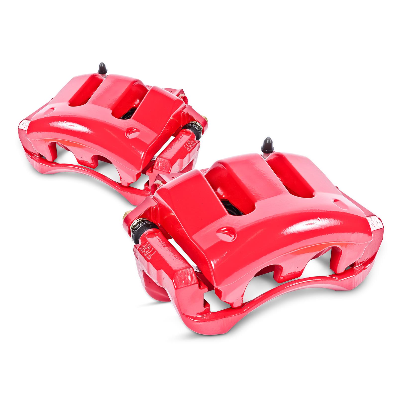

I ordered these:
Power Stop [FONT=Arial, Helvetica, sans-serif]S4926
http://www.rockauto.com/catalog/moreinfo.php?pk=4491111&jnid=2&jpid=0
