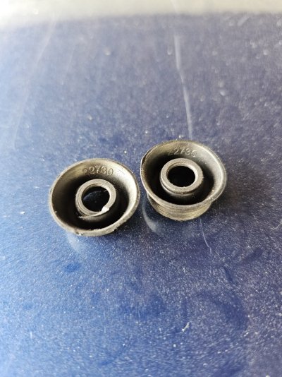

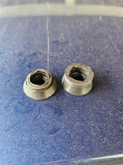

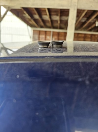

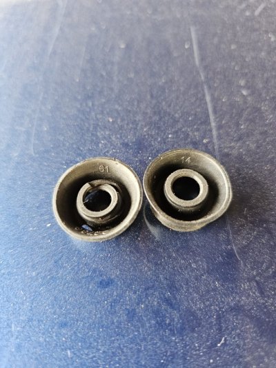

Rebuilding passenger rear caliper due to actuater adjuster bolt seal leak ( parking brake bolt thay pushes piston in)
The rebuild kit comes with a bigger seal that has a hard un squishable surface so i cant get it in the hole leading me to believe they used different seals.
The seal part is 22370 and there a 61 on the other side, but fords rebuild kit comes with 22370 and 14 on the other side. No matter how hard i tried it wouldnt go in the hole. Any help finding this exact seal or a kit with it in there would be amazing.
cavero
Jun 30, 2012
896
270
NoVA
Did the bottom of the original seal rip off and stay in the caliper? I haven't done this myself but that's what it looks like could've happened from the pictures
nova197
Mar 30, 2025
United states
Damn... you were totally right. The rubber completely corroded and the washer was crushed to the caliper so it looked like one piece. Had to pry it out. Thankyou so much i literally would have never even tried
