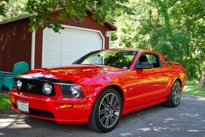

Just some food for thought based on what I read about the car you are looking at. I bought a 2006 GT Premium from a local car dealer in 2013. He bought the car at an auction since it looked pretty nice and had a lot of options.
The car had 147,500 highway miles and we speculated that the car was owned by a sales rep or someone who did a lot of highway driving. Since the leather interior was in very good condition and didn't show any noticeable wear, we suspected that the car was owned by either a woman or a small man.
When I test drove the car it had horrible hesitation. It was like a delayed reaction as you stepped on the gas to get the car moving and then it would put you back in the seat. The culprit was a very dirty throttle intake. It was caked with black carbon but once it was cleaned the car had instantaneous power.
Not knowing what kind of maintenance the car had received other than oil changes, I had my repair shop do a BG Automatic Transmission exchange, a BG radiator flush and BG Brake and Power Steering flushes.
The car needed new tie rods, a new serpentine belt, a BG Fuel Injection Service and a tune up. I later added 8 new MSD Coil Packs as two of the originals died. At least at this point I had a base line of maintenance for the car. I also replaced the half worn Pirelli tires for 4 new Goodyear Eagle RSA All Season tires which still look brand new.
The engine and transmission performance has increased dramatically! The car now has 165,000 miles and looks and drives like new. One of my friends from the Mustang Club of Maryland drove my car quite a bit 2 years ago as I was recovering from surgery to repair a torn quad muscle in my right leg. She has a 2005 GT Premium with about 60,000 miles. She told me that my car feels much tighter than hers.
The dealer had a hard time selling this car because people were afraid of the mileage. However, as a retired Sales and Marketing Professional, I used to put 25,000 or so on my vehicles every year so I wasn't afraid of the mileage. By the time I sold my 2002 V6 Mustang this car had dropped in price from $12 K to $9 K! I sold my 2002 Mustang for $7,500 so this car only cost me $1,500! In addition, the dealer replaced the stock 18" tires with 19" Mustang GT wheels that came from a 2010 Mustang GT.
There is a possibility that some of the issues I had with this car may pertain to the Mustang you're considering. Good luck whichever way you go!Carolyn's Croftgate Detail 2015 002.JPG
