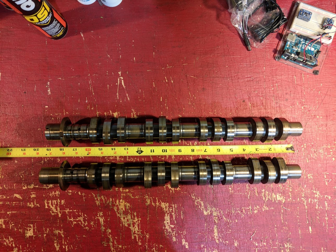

Is it at all possible you installed the cams opposite their correct side? One of the cams (passenger side?) is a good deal longer than the other to make room for the timing chains. I feel like there'd be some other indication that they're in the wrong head, but it doesn't hurt to check the simplest thing first. Out of curiousity, which side of the car did that sensor come out of?
Horrible picture, but hopefully it illustrates my point well enough.
After that, maybe make sure the key in the phaser is fully seated into the keyway in the cam?
Apart from those two things, I can't imagine why one of the phasers would have so little clearance as to actually hit one of the cam position sensors.
Cam sensor is from passenger side.
