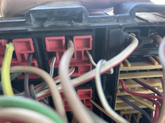

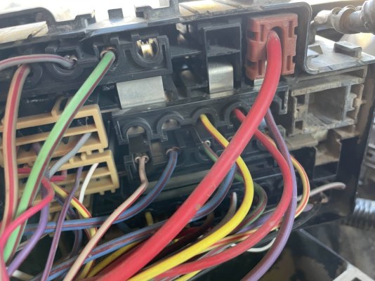

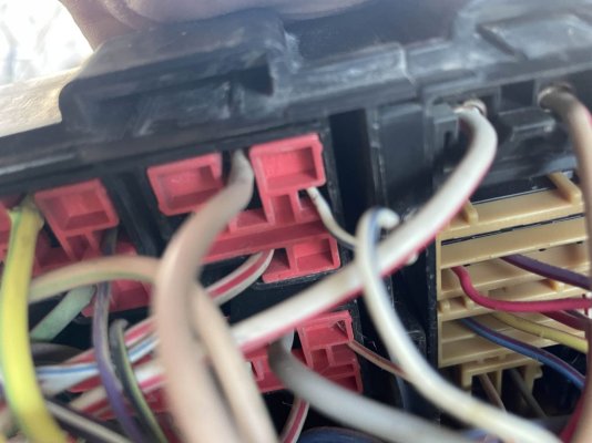

Recientemente adquirí un v6 2013 con algunas fallas, nada grave excepto esto, el ventilador de alta siempre está activo y el de baja no, ya revise el cableado y parece estar bien, ya cambie los relevadores, el ect no lo cambien porque si lee en forscan, aun así no se si descartarlo, código p0645 y recientemente p0481 pero no se si sea por que esta moviendo cosas porque no lo marcaba antes, en forcan el HFC dice si falla y yo No puedo activar LFC desde forscan, no sé qué más descartar o cambiar el PCM, se agradece cualquier ayuda.

I recently acquired a 2013 v6 with some faults, nothing serious except this, the high fan is always active and the low one is not active, I already checked the wiring and it seems to be fine, I already changed the relays, the ect do not change it because if it reads in forscan, even so I don't know whether to discard it, code p0645 and recently p0481 but I don't know if it's because it's moving things because it didn't mark it before, in forcan the HFC says yes fault and I can't turn on LFC from forscan, I don't know what else to discard or change the PCM, any help is appreciated.
You need to lift up the fuse panel and look at the underside of the panel where the fan relay is. Almost guaranteed you will find burnt wiring.
