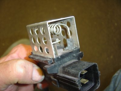

Take the temp switch (fan high/low) unit off your fan and look at it. The unit that you plug the fan connection into. They have been known to fail. I thought I had a melted one here in my garage but cant find it.

It just snaps in the fan housing, it is a bugger to get out though. Look at the red wire and see if it is showing and discoloration, if it is then it is most likely toast. Ford part, I think the dealer had it in stock. Good luck.

The resistor is basically it, that is what controls fan speed...I guess it really isn't technically a switch. Low speed relay runs through the resistor and makes the fan run slower. High speed relay by-passes the resistor and fan runs faster.
