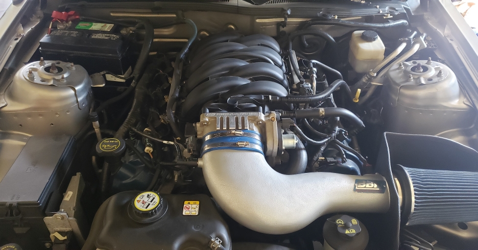

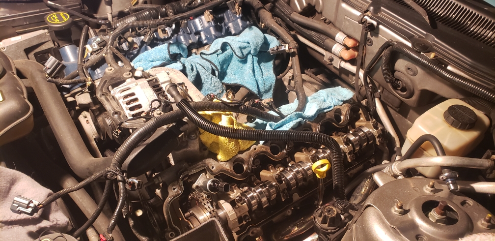

In the last week I've installed: Ford racing valve covers, MSD coil packs, holley sniper intake manifold, holley sniper fuel rails, and I changed the spark plugs(none broke thank God).
Valve covers were an easy straightforward install.
Coil packs were easy
Plugs were easy

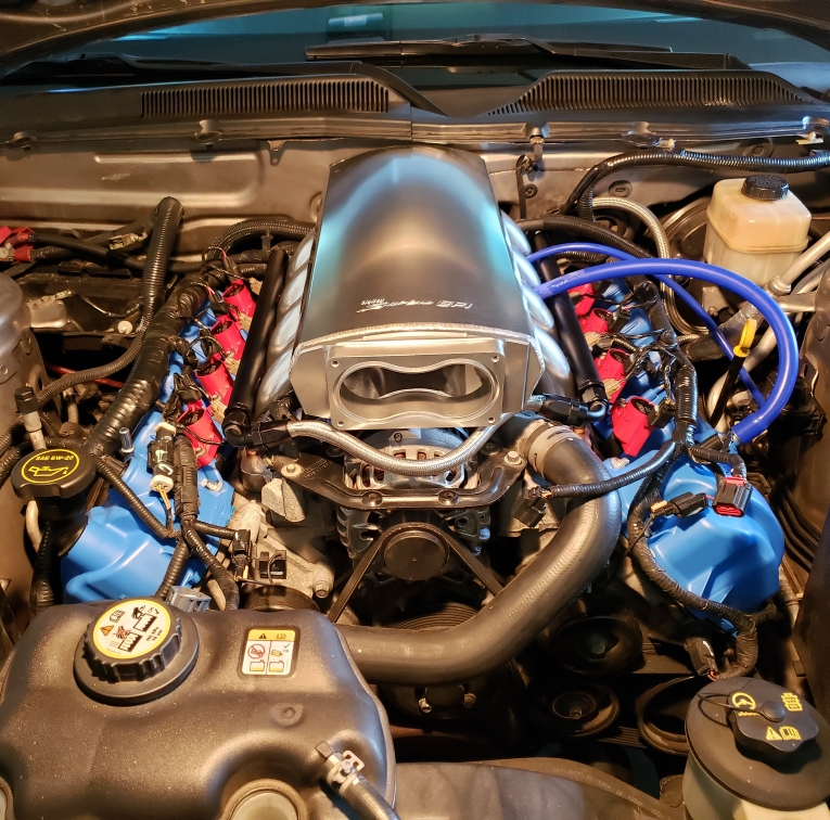

Now the intake...
Its absolutely beautiful 15/10 on looks. Install was pretty easy and all of the hardware for it was included. 4 vacuum line barb fittings hidden underneath. Fuel injector holes on the driverside were maybe 2cm off, no biggie, holes plenty big enough to not cause an issue. Hardware is pretty decent. Welds look great. Front 2 mounting holes were elongated a little bit. Also you wont need CMCV deletes or spacers because the intake is long enough to compensate. Unless you have a scoop on your hood dont buy this because it will not fit. Its TALL.

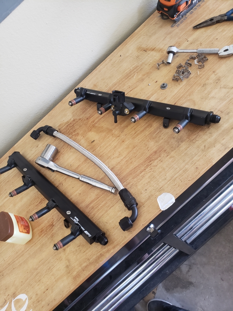

NOW for the fuel rails. They look good but design is piss poor. AN -8 fittings are used on all 4 corners(included). A crossover hose is also included.
BUT, the FRPS mounting bracket is pointing down. Your stock vacuum lines wont be long enough. You WILL have to cut the harness apart and pull the FRPS connector back to make it reach the sensor.
What Holley doesnt include is any way to connect your fuel feed line to the rails. You will have to separately buy an AN-8 to male QD fitting and a AN -6 to AN -8 conversion fitting. If you dont have the tool to unhook the stock fuel line QDs then invest in one. You will have to make your own length braided line in AN-8 to connect to your metal fuel line for a feed.
