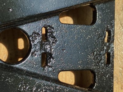

The cause is that aluminum oxidizes, it oxidizes to an extreme in the presence of iron, further accelerated by iron oxide. This is maybe more understandable if you relate it to an aluminum k member instead of a hood. Or, the trans crossmember in th s197.... the steel in the rubber isolators for the exhaust rot away their mounting holes in the crossmember as they rust.
Here. Is a picture of the crossmember I just p coated.
