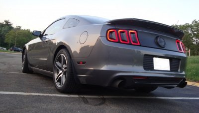

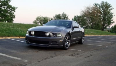

A couple of shots for you with the 275/40/18 Continental DWS's, to show how they fit and give you an idea of the overall ride height.
This was sitting on Steeda Sport Springs:
View attachment 67337 View attachment 67338
