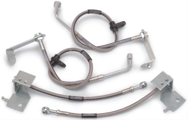

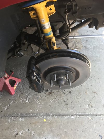

If you're talking about getting the front Brembo brake setup I got mine at O'Reilly's. Just ask for GT500 calipers, pads and rotors for a 2008 GT500. Cost me about $400 for the entire setup (probably higher now). Everything was plug & play. Just bolts right up. I'd recommend replacing all of the rubber brake lines with steel braided at the same time.
