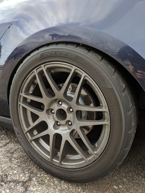

Might be Forgestar F14.
I have those as my "track day set" in 18x11. They are available in various amounts of 'concave' and in a wide variety of offsets. And they do clear the SVT/GT500/Brembo calipers without a spacer.

They look to be Forgestar F14's in their shallow dish design
Norms pic above is a deep dish and they make a super deep dish as well
Here's another shot of a deep dish in 18x11

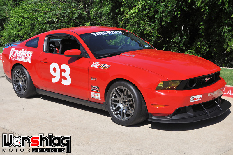

What was posted initially first was definitely a Forgestar F14. This is a flow formed/rotary forged wheel that comes in a LOT of sizes and can be CUSTOM MADE TO ORDER in a wide range of offsets, colors, etc. A bespoke wheel at a very reasonable price.
We started ordering these in 2012 with our first set being this 18x11" front and 18x12" rear using a 315/35/18 Kumho R-compound track tire, above. Since then we have sold hundreds of sets for S197 and S550 Mustangs, using offsets we have tweaked and perfected for each chassis. We also do 18x10 and 19x10" wheels for folks not ready to go "all in" just yet. We make the 11" wide fronts and rears with significantly different offsets - so that the wheel/tire does not "poke" past the fenders or rub on the inside, but they also do not rotate front to back.

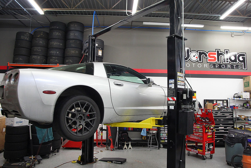

The TSW someone mentioned is just a cheap, shelf stock wheel that is pretty heavy, and not able to be ordered in custom widths/offsets. Again, it comes usually in one size and is available for "some cars", but it is nothing special. Cheap, heavy, and limited options.
We took the TSWs off the C5 above and made this 18x11/ 315/30/18 set for it, which was used in Optima competition (its on 18x12" front and 18x13" rear Forgestars with flares now). We make several "wide wheel" packages for a number of cars other than the S197 or S550 as well, and we make them with custom ordered Forgestar wheels.
