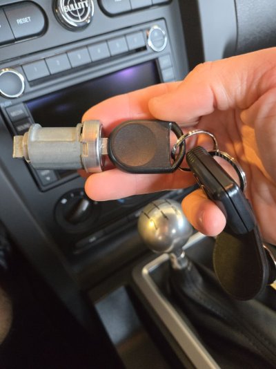

So this happened last weekend when I parked and went to pull the key out of my 2008 Bullitt. I can reinsert the cylinder, with the key in place, and everything works as expected. Some background: last year I noticed that the door bell had stopped dinging when I left the key in the ignition (car off) and opened the door. Perhaps whatever broke then was a lead up to this?
Not 100% sure what to do here. Any input appreciated!
Thanks y'all

It's a feature! Take it with you. A thief would need a chipped screwdriver to steal it...

had the same issues ( 2008 Bullitt also )
I bought a new cylinder at RockAuto .. and used the old "locks" of the brocken cylinder to save my original keys. "Recoding "the cylinder is some work , pacient work... but it works.

if I were you... I would not drive one inch more with the car. If the steering look comes in because of a bump.. a dip..or what ever... bad cards.
