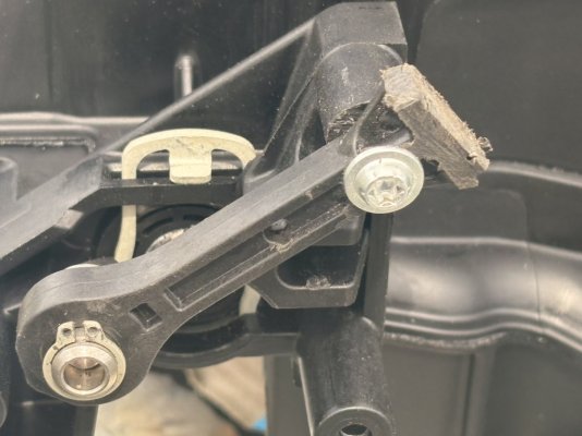

Hello everyone just thought I would post this maybe it will help someone. There’s no need in buying those expensive block off plates when you already have the components to make your own. I just used the rods from the vacuum actuators & screws that the actuators where mounted with just cut them off and drill a hole in the end to mount them to the existing actuator mounting post will work just as good.
