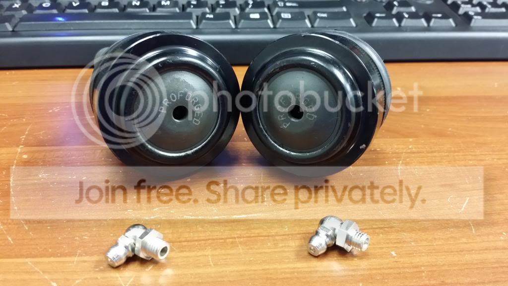

I am thinking our tall ball joints will work on your guys arms.
I would happily give you (whoever wants some) a little discount on them, if you would like to try them out. Retail is like $59/each.
We went through this several years ago with our previous ball joint supplier (who MANY people use currently) - so we designed some new ones, and source them from Pro-Forged.
So far, they are proving to be absolutely awesome. I've got guys who have been coursing, HPDE's, etc....on our arms with these ball joints for several years now.
Apex50
Mar 14, 2012
178
Apex, NC
I'd be willing to try them. I like the right angle grease fittings, would be easier to access than the straight connections on the Steedas
