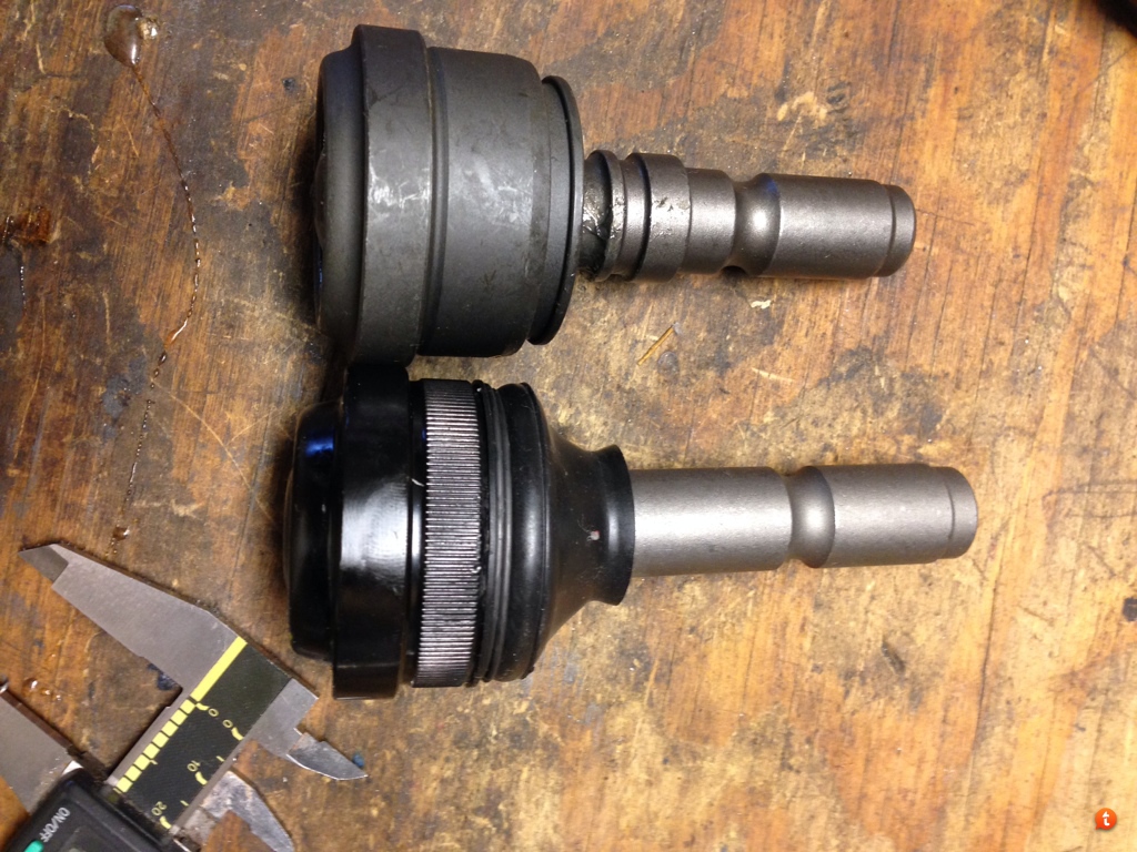

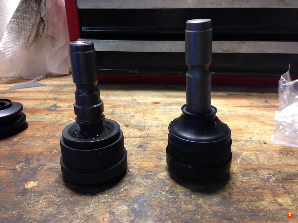

Got the BMR tall joints. Compared them to the Steedas- the diameter for control arm and knuckle are the same for both. The BMR's are longer, but I don't think enough to get near the bottom of the strut. One concern I have is that there isn't a shoulder to locate the control arm. Is this feature necessary? Seems like you're relying solely on the clamping force from the control arm. If not, do I just set the height to match the Steeda?
Hmmm.... This is all by eyeball, but... Both balljoints should be press-fit into the control arms, and pressed in until the cast-in flange bottoms. On top of the control arm, both should have a snap-ring retainer. I know the Steeda (X5) does, and I'm assuming that the BMR does as well. Yes, the stud on the BMR does look longer, but if you see the machined groove on the stud, they both look the same from there to the end of the stud. As such, there should be a TON of room between the end of that stud and the strut, so no worries there. As for "installed height," There is a pinch-bolt running through the knuckle that rides in that machined groove. Slip the knuckle down the stud until the machined groove lines up with the pinch-bolt hole, then insert the bolt and tighten to spec. From the above pic, it appears that the BMR ball joint offers a slightly greater installed height than the Steeda. Plus: This raises the front roll center even higher than with the Steeda, allowing for more "drop" up front before compromising the geometry. Minus: Requires more clearance room between hub center and wheel hoop for both the ball-joint body, and you'll need more stack-up for bump-steer correction, also requiring more wheel clearance. Also puts more force laterally on the ball joint stud. I'm going to assume that BMR did their homework and that it'll all still fit inside of a "typical" 18" wheel.
