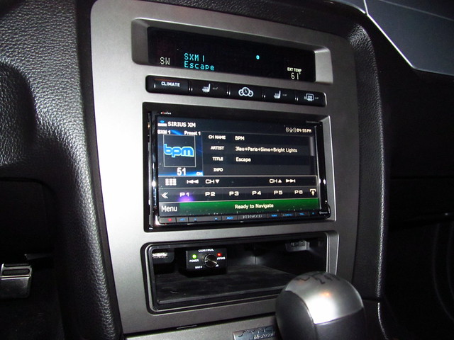

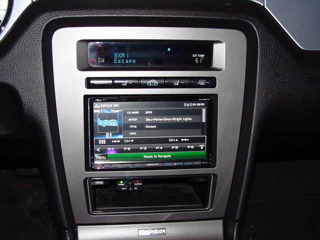

Picked up the new ADS Maestro, ADS dash kit and Kenwood DNX890HD for the mustang.
Install was pretty straight forward. Accessing the wire for SYNC and OBDII was a bit of a pain though. Really loving how much you can customize the setup and how much better the audio quality is.

IMG_1016 by riored4v, on Flickr

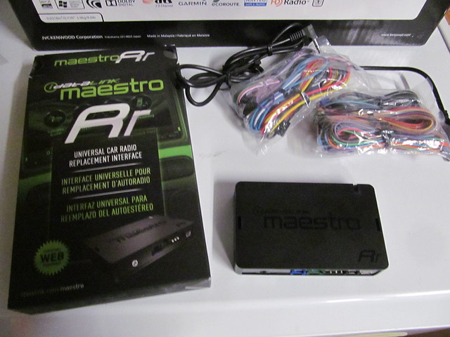

Maestro RR

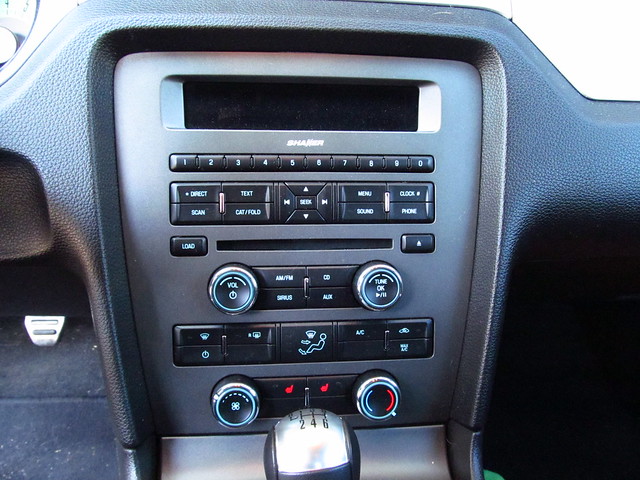

Stock

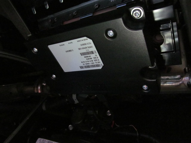

SYNC module located behind glove box

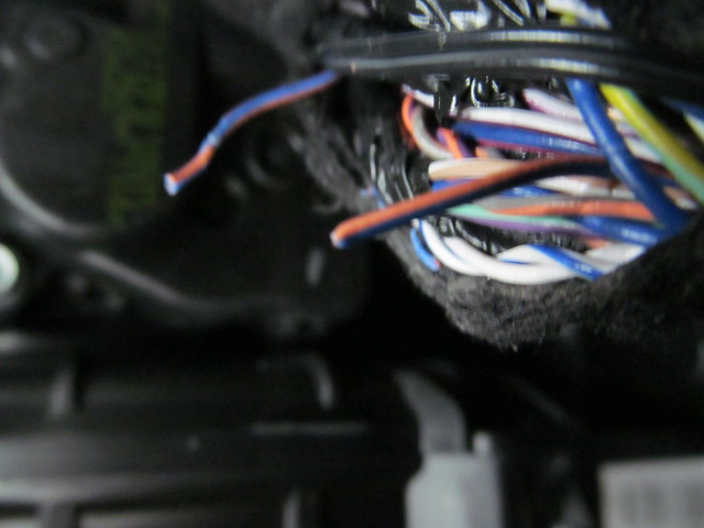

Sh1tty pic.. but the SYNC wire that needed to be tested. Should read 5v and then drop when the SYNC voice command button is pushed.

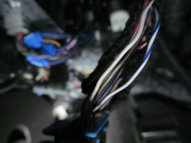

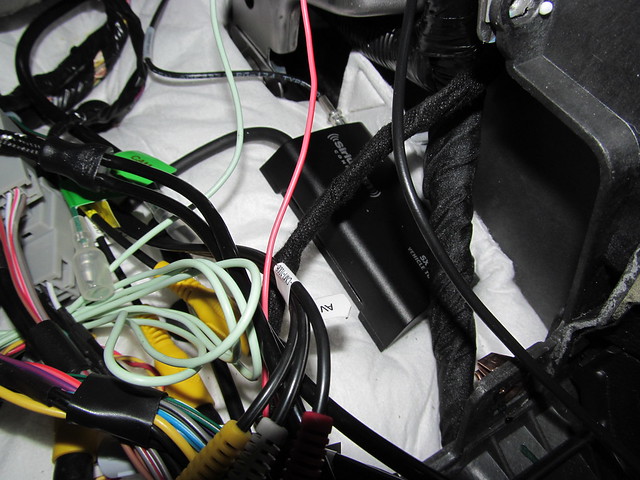

Pulled the OBD2 harness out from the clip and had to splice in to these 2 wires

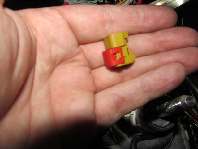

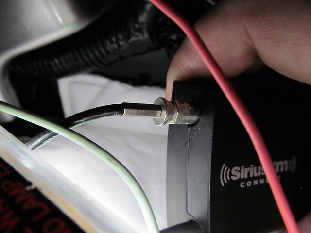

For splicing the factory SiriusXM antenna, you have to remove this clip after taking the cable out of the factory head unit
IMG_1024 by riored4v, on Flickr
You can then put it in the aftermarket tuner. Its a slightly loose fit, so some epoxy was used on the outside portion.
IMG_1023 by riored4v, on Flickr
Tuner in place
IMG_1025 by riored4v, on Flickr

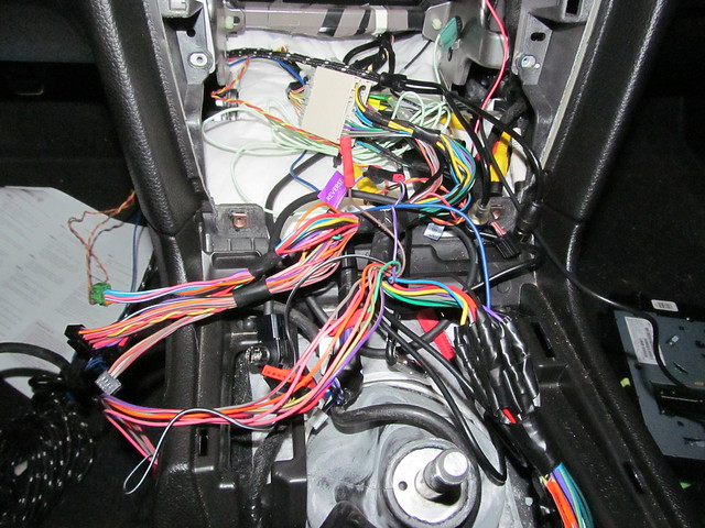

Mess of wires from the ADS harness

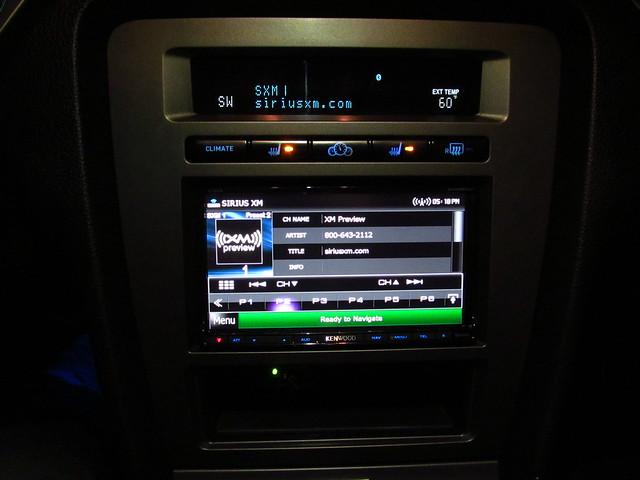

Then you plug the RR module in to the computer, program it and flash it and it fires everything up.
IMG_1031 by riored4v, on Flickr
Unit come with a ton of different buttons so you can customize the layout of the dash kit.

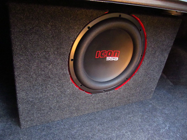

Also had to run RCA's back for rest of the stereo. So much nicer going through an aftermarket deck now.
IMG_1040 by riored4v, on Flickr
