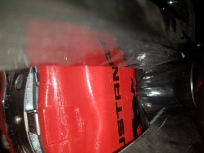

I successfully got em mounted and working with a 10mm spacer. I may increase it to a 11 or 12mm for peace of mind as there's only about 1-1.5mm of clearance with the current spacer.

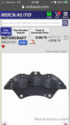

Okay, 2018 Brembo 6-pot calipers @ Rock Auto, pn BRCF 430 and BRCF 431, any Opinions on use in an S197? (Aside from usual wheel-fitment issues)
DA4F39BC-09DF-4C27-A7BF-268A04B8FA79.png 13DEDF59-B9AD-435B-B46B-DF3A15464D56.png
Correct me if I’m wrong - the difference between these and the earlier 6-piston is a decreasing piston diameter vs. early had all 6 same diameter, yes? (or have I misread something again?)

These are kind of big and heavy with the big 15 inch rotors. You will need 19 inch wheels and spacers of some sort with S197 15 inch 41 lbs rotor. Although this system might get above 1g stopping. You really must work all four wheels to get the ABS right. Brembo brakes for a 2014 have s special ABS system. I think it's to balance out the small back brakes. I decided to use 2009 GT500 fronts with 2014 GT500 backs with the standard ABS system. Amazon for the calibers and Rockauto for the rotors and pads. Works perfect after 3 bleeds.

Oh, I intend on putting the larger rear rotors on as well. I just saw these on sale, thought it might be a good start for a Brembo 6-piston retrofit.
S197’s are Big Girls, and brakes Ford put on them up-‘til the end were marginally adequate, to put it mildly.
I’m also a Cheap Bastich. $240 apiece (eating the core) is a price I feel like I can stomach.
I’ve given this a bit of thought, just wanted a gut-check to see if there was something I grossly over-looked in the ‘15-‘18 S550 Brembo fitment.

those are “remanufactured” from Nugeon. Who knows if they’re real or not with that price.
I bought and installed a pair from O'Reilly, the ones I got were definitely cheap copies. I needed to have one replaced as it was leaking by the piston seal, and the replacement had different hardware as well as the bleeders took a different wrench size. They are working well now, but I would not recommend.
