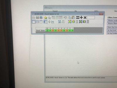

Here ya go Laga:
These pictures are 1. from my tune file that shows the knock sensor to cyl assignment. This is the stock OEM mapping & 2. from the FWM wiring schematic showing the wire color designation to designate knock sensor #1 from #2.
I assume that knock sensor #1 correlates to knock sensor #0 in tune & knock sensor #2 matches knock sensor #1 in tune......knock sensor #0 is B1, knock sensor #1 is B2.
The assignment seems to follow the engine firing order in a staggered pattern except for #5 & #6 cyl which are the only 2 adjacent firing cyl's that are using the same knock sensor (#1 for B2).
Hope this helps.

If they were swapped from their original location, would this show up as excessive detonation?
Yes, if these knock sensors are switched across cyl banks from their original mounting, this can throw off the per cylinder knock threshold sensitivity tuning settings that were set in the tune based on the original cyl-to-sensor assignments as set in the tune (please note that these assignments also follow the cyl pairing to crank journal....ie, cyl #1 & #5 on the 1st pair, cyl #2 & #6 on the 2nd pair, etc in addition to firing order) making some cylinders more sensitive to knock than prior, some less.
This is why I provided the tune cyl-to-sensor assignment along w\ the wiring diagram pictures showing the harness side connector wire colors to ID them as there are no other markings on the actual sensors that do......at least I didn't see any on mine when I had my IM off several times.
These knock sensors that fit our MY S197's use a siamese-type connector (both sensors use the same M-F connector housing\socket) thus I can easily see these getting switched across banks unless this is known prior & are labeled to facilitate them getting installed back on original bank mountings to prevent this from happening.

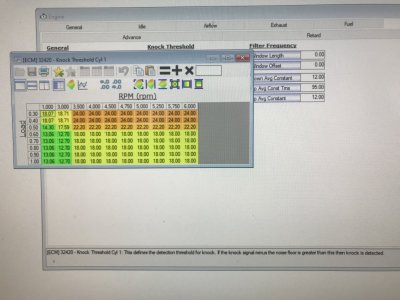

PS--I provided below a picture of the cyl knock threshold sensitivity tuning maps to finish showing this correlation thus give flesh to what I typed above.

Once it's all fixed...and...'back to normal', can the knock sensor sensitivity / threshold be adjusted in the tune? The story I got was when the PD blower is installed, the knock sensor threshold has to be reduced a bit, so it's not false tripping from the blower assy.
Yes. That's what the per cyl threshold maps are for.......setting the KS sensitivity thresholds per cyl-to-KS assignment. Anything that attaches to the engine that generates any noise\frequency needs to be accounted for in the KS threshold maps or it'll be picked up as a false knock signal.

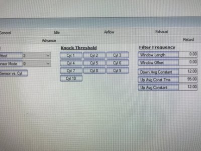

Here is a picture of 1 of these maps opened so you can see w\ an explanation of how this works in GUI below (HPTuners Editor software):
