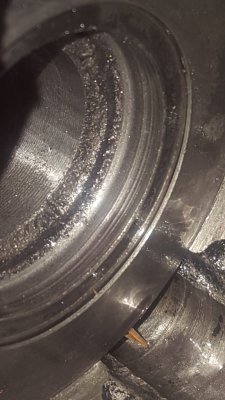

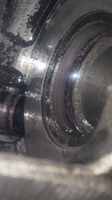

I got to digging some more, went and looked at my old axles and side gears. if you put the gear on the axle and move it back and forth the axle is a big ass tuning fork. the sound is heard in the end opposite the tap. Then, I noticed on the side gear, where it seats in the carrier looks like a piece of slag on the face of it, like a spun bearing. so, tore the carrier apart again. needless to say new carrier being installed.
thanks for everyone's input and help!
