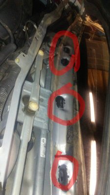

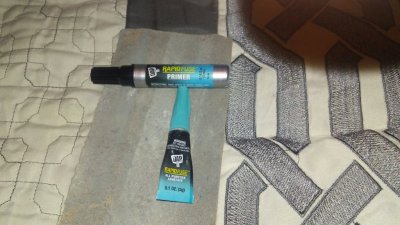

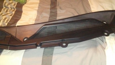

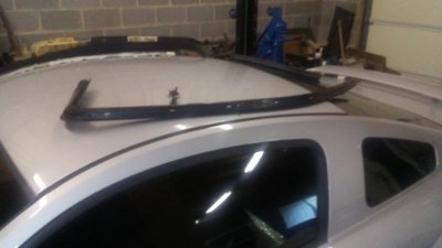

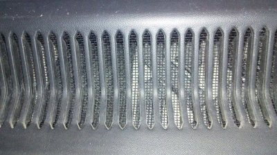

0330191529a.jpg 0403190001.jpg 0403190002b.jpg 0403190002a.jpg 20210517_204753.jpg 0330191530.jpg 0403190003a.jpg Here are two of the three most common water entry points and how I fixed them.
First I add aluminum screen on the backside of the cowl cover, this keeps out the leaves and small seeds that fall of the trees next to my driveway, then I removed the deteriorated foam gaskets under the cowl snap locks on the cowl and used seam sealer to glue them back in place. Last thing I did was to use a rubber gasket sealer stuff to seal around the top door seals.
Here's some photos of what I did. One last thing. You still have to clean out the rubber grommets at the bottom of the cowl in the engine bay from time to time.
