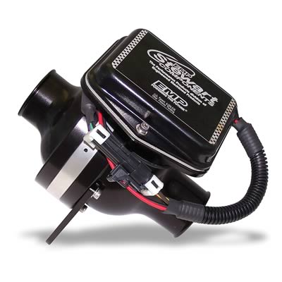

however i noticed that when my temps are hovering around 220 or so.. if i rev and hold RPM around 3,000 without load.. coolant temp drops below 210 in seconds.. meaning the mechanical pump doesn't flow enough at low engine speeds.
now i'm thinking on whether or not to add an inline electric pump.. something like the EMP Stewart 55GPM pump.
i've had this on other cars with great results
of course i'm still thinking about ways to extract heat from under the hood.. but i'll get to that once this is done :)
