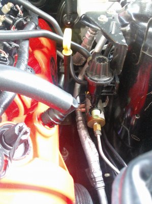

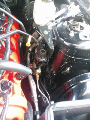

I have the SLP line lock. Have used it hundreds of times and it has been on the car for over 50k miles. Still works.
If you have a hard time figuring out which way the hoses go message me. I have pics of the right way. It will 'work' the other way but you will have to force it and it looks a bit awkward IMO.

do you mind posting the pics for posterity sake? im curious what you're talking about...
These pics are the SLP lines done the right way in my car.
EDIT I just realized this only shows solenoid orientation. Which must also be done correctly. But if you look at the bend coming out the rest should be self explanatory since there are only 2 lines.
